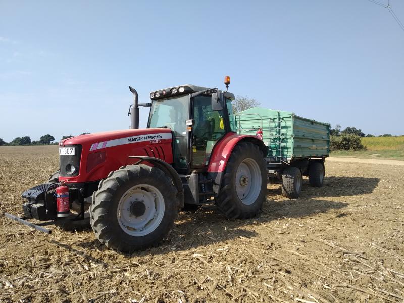

#23257 GREVEN
2020-10-11 14:47:50
Új traktor.
